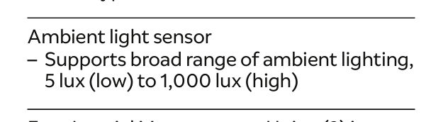

I understand that the Magic Leap 2 device supports ambient light measurements in the range of 5 lux (low) to 1,000 lux (high). I have also read a note stating that it is intended for indoor use only, so I assumed the maximum value would be capped at 1,000 lux.

Since the documentation says the sensor supports up to 1,000 lux, I’d like to know:

Hey @JunsuSong ,
Currently, Magic Leap does not publish the lux range of the ambient light sensor hardware.
The 5-1000 lux value you are referring to is the recommended indoor operating range of the Magic Leap device to reduce any issues stemming from the users environment.
I’ll look into seeing if I can find and share a range of values for you, but in the meantime, just know that you can get a wider range than 5-1000 lux from the sensor.
