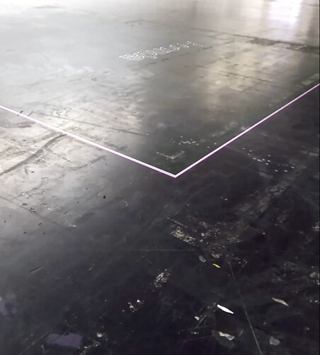

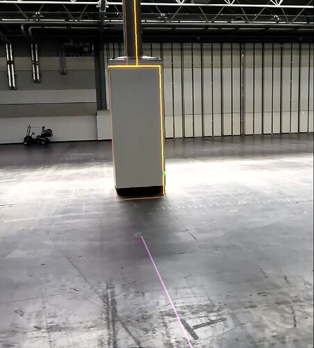

I flew to the site and got more insight on the conditions there. I also brought an experimental feature to override the tilt but hit a major problem in testing it. That was extreme drift. Historically, we’ve been able to treat the ML2 as a near drift-free device. But in these very large rooms with plain, if messy, black floor. Some shine to it. We were experiencing as much drift as we usually see in iPads. walking in just a 20 meter circle would see as much as .2m offset from the expected location. If we return to the starting location, it would snap back. But by introducing warping and seams in the map, we have clashes between the alignment points and in general, the customer can’t trust the alignment as much as they need to.
I would love more insight on the particulars of the SLAM that are failing so severely in this environment. Is it using the lidar as well as the cameras? Could that be why we’re getting the height drifting so much with black floors? Is it using a pnp (or similar) that fails with planar features?
Because the floor, while black and featureless in shape, was actually quite messy, with perfectly unique scuffs and tape marks and other visual details that should contribute well. Is there anything we can do in terms of settings or modes or anything that could help improve this tracking? significant or time-consuming changes to the environment are a non-starter. We sort of get what we get there.
