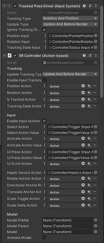

I am trying to get started with my ML2, Unity and Open XR. I have a small problem with the controller that I can’t figure out. under my XR origin and camera offset I have the right controller. In the XR controller action based, I have hooked up the bindings for position to pointer/position for magic leap controller (rotation is set to rotation).
I have an XR Ray interactor and a XR interactor Line Visual. When I run my app the close end of the ray is stuck to the controller but the far end of the ray is just stuck at the same point off in space. So as I move the controller around the close end of the ray follows me but the far stays put. So in short it does not act like the controller is supposed to.

Looks like this was related to rotation not working properly. For some reason ML controller rotation seems to do nothing.
Hey @eric_engineer ,
Glad you got this figured out!
The line renderer in Unity is actually just a 2D ‘billboard’ texture that always faces the camera, so rotating the controller will not appear to rotate the line since it’s trying to face the camera at all times.

Anyway for my controller I have a tracked pose driver, XR controller (action based), Xray interactor, xr interactor line visual.
