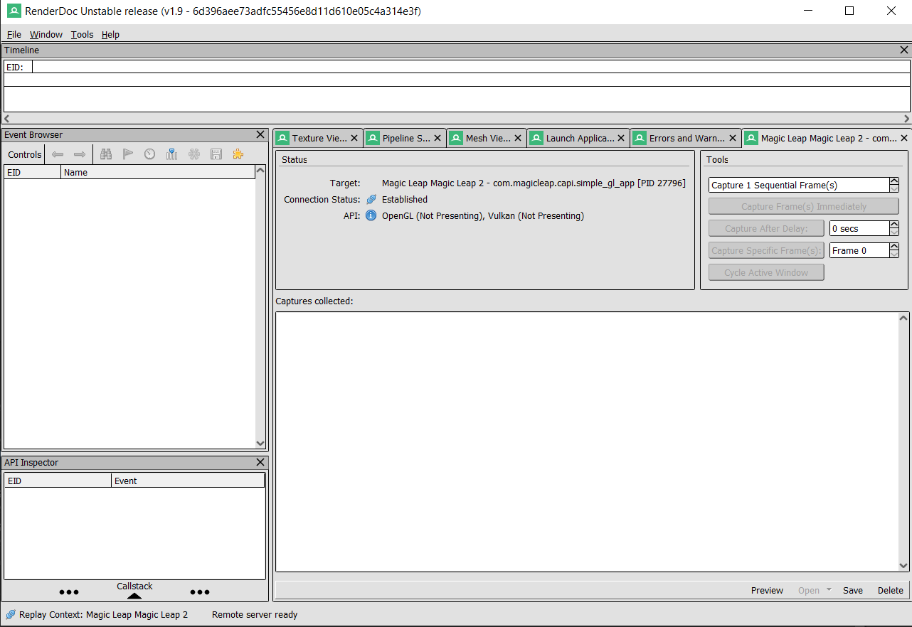

when I launch the RenderDoc, it says: Unstable release version 1.9 just in case you need the version number.
however, it is connected with no problem, then I go and launch any app (such as the controller sample app) from the RenderDoc UI, the app is launched but it is waiting for the debugger and if I try to connect a debugger to it fails (I read here that renderdoc is don't work with android studio debugging)

I was expecting it to record some frames. but it is empty.
