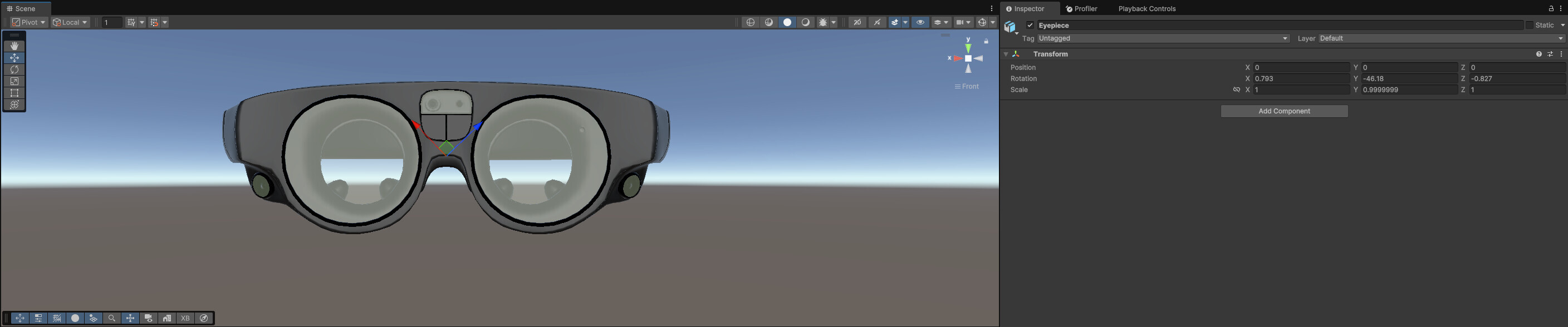

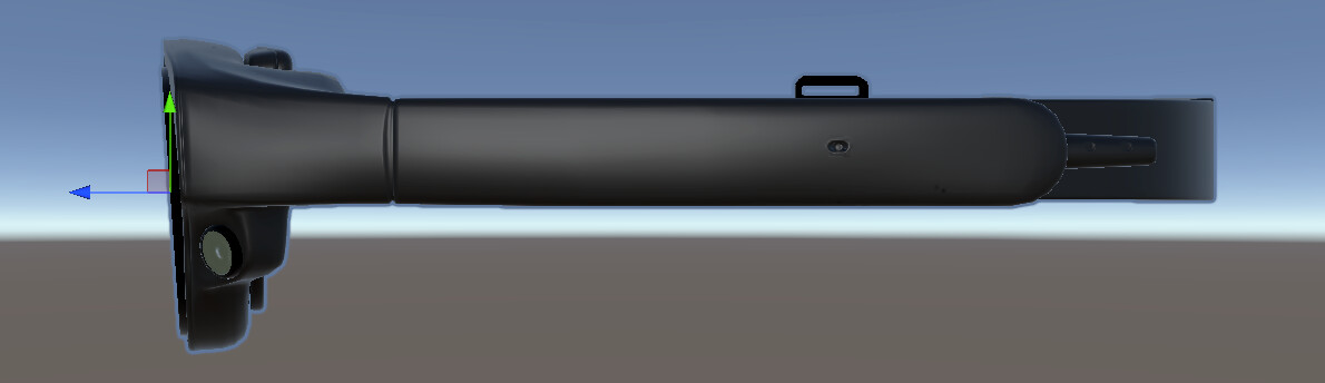

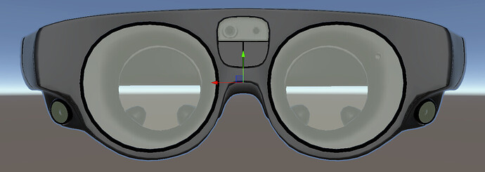

1. Origin differences between model files
We notice a difference between the origin of the FBX file and the STEP file provided in the Magic Leap downloads.
Which of these should be considered the true origin position of the device β€” the FBX or the STEP reference?
FBX File (ML2-Headset_1.2.1.fbx)
STEP File (ML2_HEADSET_3D-CAD_BASE_20221103.stp)

Hi @P.Gagelas
Great question! The FBX model has the more accurate representation of the origin. However, please note that these models are just a 3D representation created by our artists so they might have some degree of error.
The Eye Center position can be obtained using the API through OpenXR. You can look at the Tracked Pose Driver on the Main camera. It uses Unity’s generic XR Biding
The origin is both the pivot and the position
