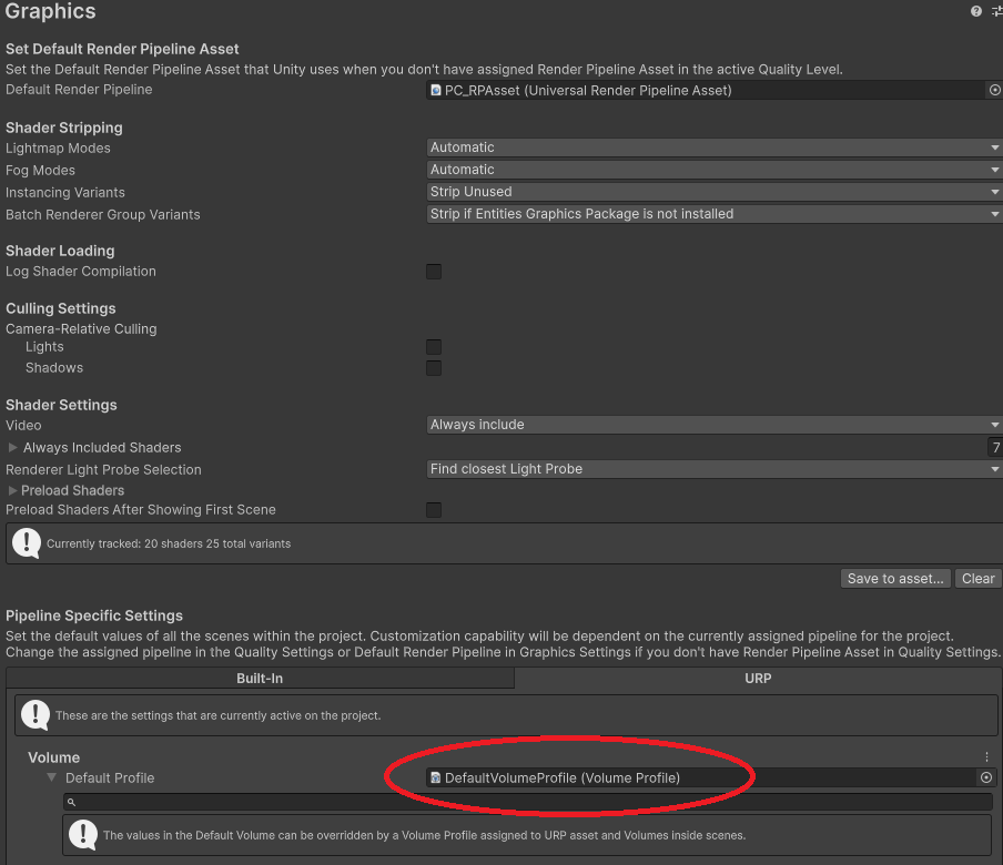

If I record a video of my app, all the non-virtual background is black.I’m using the default URP. I have disabled HDR as suggested here (but can’t “Uncheck the Post Processing option” as it is not there in Unity 6.2) and tried to remove everything I could find about post-processing, but still I get the black background. I also unchecked the post-processing tick on the camera.
Could someone please give me some steps to solve this?

So I tried all that:
  • Camera > Background type: solid color, black (0,0,0,0)
  • Camera > Rendering > Post-processing: unchecked
  • Project Settings > Graphics > Pipeline Specific Settings
    • URP: Here I cannot use “None” for the default profile (the editor won’t pick it), so I keep the DefaultVolumeProfile. Maybe the issue? But I tried with a VolumeProfile with everything unchecked too.
  • URP Asset:
    • Unchecked HDR
    • Set “None” for the Volume Profile
  • Renderer Asset (Universal Renderer Data)
    • Unchecked Post-Processing
    • Removed all renderer features
  • No volume in my scene
  • Tested recording both within the headset and via the ML hub
  • I keep having the black background.
Would you maybe have URP/renderer assets that “work” so I can test them? Or maybe other suggestions?
Thanks a lot!
Arnaud

Hello,
Thanks a lot for the reply. This still wasn’t it but I finally figured that I was modifying the default URP Asset while a Quality level using another URP asset was actually used by the application. Once I unchecked HDR on that, problem was solved! :man_facepalming:
