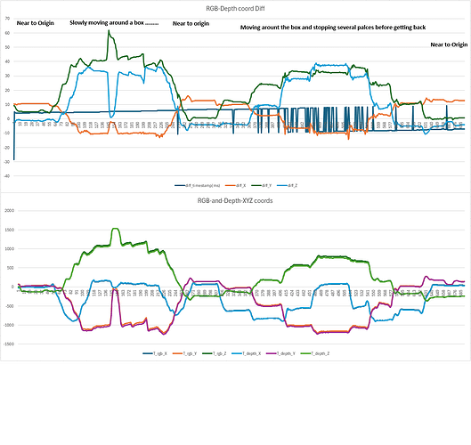

But if we check the posees got for the rgb and depth frame we realize that there are larger and larger differences as we move further from the origin/starting point.
On the next charts you can see as we move around a box 2 times. first continously, second stopping for a while several times.
The first chart shows the dfferences the secondo one shows the absolut position values in mm.
On he first chart also displaced the capturetime difference in ms.
We cheched it on multiple devices. it shows almost the same difference on different devices too.
What could couse this? How could we avoid this.
Aditional info: we scanned the a local space before the tests.

And what we se is, that if we get rgb and depth frames which has around 0.05 sec capturetime difference only, and we capture frames even with a “still” headset, the pose (x,y,z) coordinates are much higher if we capture frames 1 meter away from the origin than when we capture frame closer to origin.
On the second graph you can see the distance from origin.
on the first you can see the error between the rgb and depth frame poses.
The correlation between the distance-from-origin and the erorr-between-rgb-depth-poses can be seen easily.
on the first graph I added remarks to section (on the top of the graph) to describe the action we took meanwhile the frames recorded.

We expect that: if we capture RGB and Depth frames at the same moment than the pose we get for the RGB frame should be very close to the pose we get for the Depth frame.
Based on our measures. It seems that, the difference (error) between the RGB pose and the closest Dept frame pose correlates with the distance from the origin.
So if we are close to the origin, thant the difference is small,
but if we move 1 meter avay from the origin, than the error is 40-50 mm on at least one direction (x,y, or z) (this comaprision does not include the orientation differences, but it is importatnt too)
It is almost the same if the device is still or moving at the moment of capturing.
When we go back near to the origin, than the error is samll again.

To see my problem a bit easier, From the 3 coordinate-difference values I calcualted the distace between the RGB and the Dept sensors , which should be fix.
But you can see, that it changes too much as we move in the space
