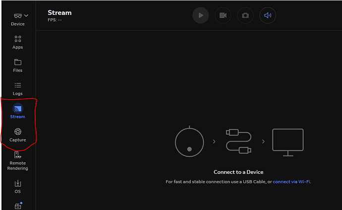

Are you using the Stream feature or the Capture feature from the MLHub?
as I wrote I’m using Hub 3 PC application. Here is the link to make sure we talk about same thing
Hub 3 page
Understood!
There are 2 options on the ML Hub, there’s the stream option or the capture option, which are you using?
I clicked “Capture” button. and Downloaded recorded video only Menu Sound fx no Microphone input.
