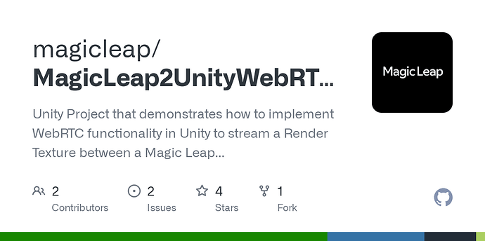

Unfortunately Device stream requires ADB Debugging to be enabled additionally, Mircast would require you to manually select the cast option in the device settings. You may want to look into using an external WebRTC service or a local server or possibly use Spectator view.
